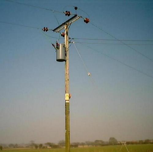

In the U.K. the xfmr primaries are always wired phase-to-phase, since our MV/HV never distributes a neutral. 3-phase xfmrs and 240/415 Y local distribution is the norm for anywhere where there are more than a few houses, but where single-phase spurs are run for remote rural homes, the HV is always run as two phases: ![[Linked Image]](https://www.electrical-contractor.net/pc/1ph_xfmr.jpg) Xfmr above is 11kV primary, 240V secondary.
Posts: 10,031 Likes: 37
OP
