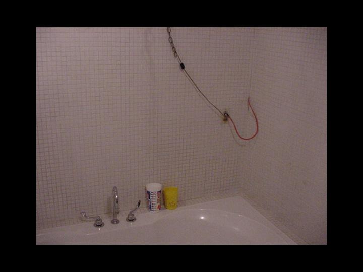

That orange extension cord is also missing the grounding pin.
Notice the round hole is up and the cap is oriented down with the flat side opposite where the ground pin should be.
So the whatever-it-is that's on the other end isn't even grounded!! You say it's a pump??? Oh man.....god forbid that thing should ever develop a short-circuit.

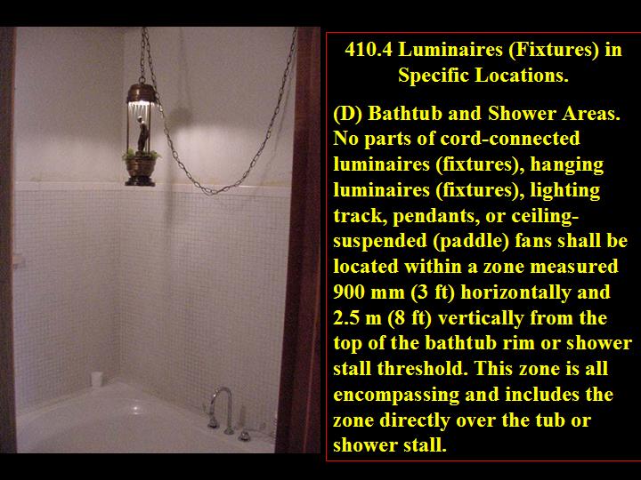

Here's the "swag lamp"!!
Those little rotary cord switches normally used for table lamps and small fans (see first pic) are not waterproof!!
If you touch a live one with a wet hand and water drips into it you WILL get a shock! I don't think you're supposed to use them in bathrooms or any such damp location.

Bewildered? Be Gambling!
Different plug and receptacle styles, but I've seen cords fed through a wall like this to reach a receptacle all too often in England as well. Thea attitude of "Hey, it works all right, so it must be O.K." is alive and well everywhere, I guess. [Linked Image]
