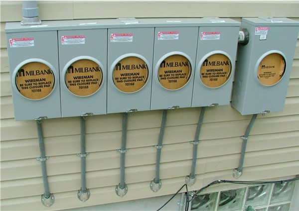

Here is another common example. This is a service a buddy of mine did.
Notice the size of the riser, it has a capacity of about 200 amps. If you add up the six main breakers inside you would get 600 amps.
Is this 'fraud'?
Should he have run a 600 amp riser for no particular reason and charge the customer a lot more money?
