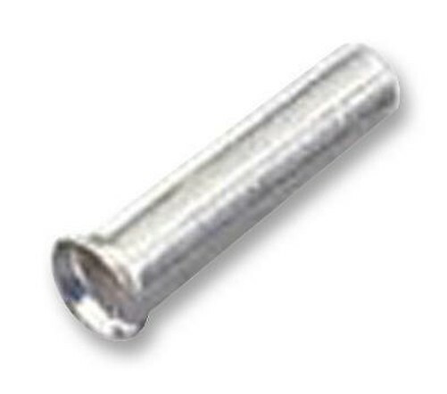

I live in a Schuko country and have experienced hot molded plugs myself.
In case the outlet is good, then It's actually the quality of the plug and the way of how the wires are connected inside.
I replaced numerous plugs of 2000W heaters with proper self-wirable plugs, and those get barely warm.
Ferrules are a must when doing that, and I also scrape the copper strands clean with a knife in such cases, before I crimp on the ferrules. Cheapo PVC cables release substances that turn the copper strands matte or even black, and that increases resistance to the ferrule or terminal.
