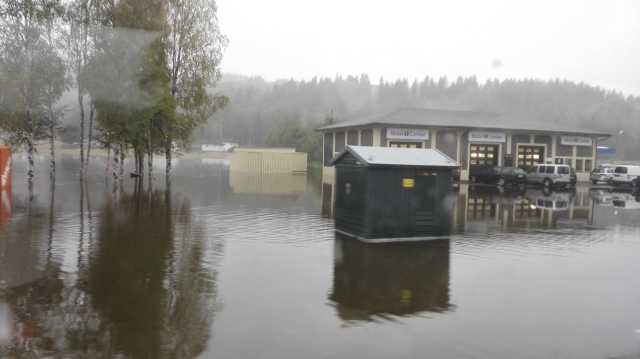

They told me, it is safer with the transformers at the ground, than in poles. I'm not so sure!
Picture taken from the bus to my job this morning.

Yikes, thats not very good. I agree, pole is better.
