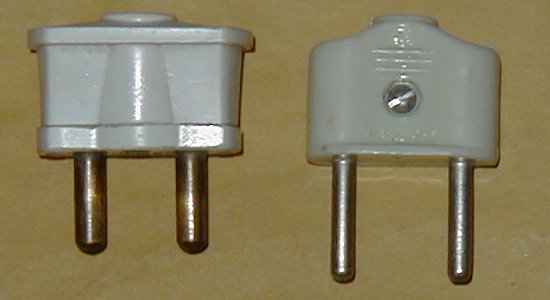

Here is a side-by-side comparison of the British 2-pin 5-amp plug (on the left) and the European equivalent (on the right). These are both older examples from the 1960s:

Both of the above have now got sleeved pins.
As you can see they're deceptively similar to a Europlug :
[Linked Image from shavers.co.uk]
It's a total pain in the ... when you go to the continent and discover that it will not fit any known socket!
Quite a lot of British and Irish tourists are baffled as to why their 2-pin shaver plug won't fit a French 2-pin socket as they look like they should fit and our shaver plugs look almost identical to CEE 7/16 2.5amp plugs used on almost every small appliance in Europe (Except here!)
