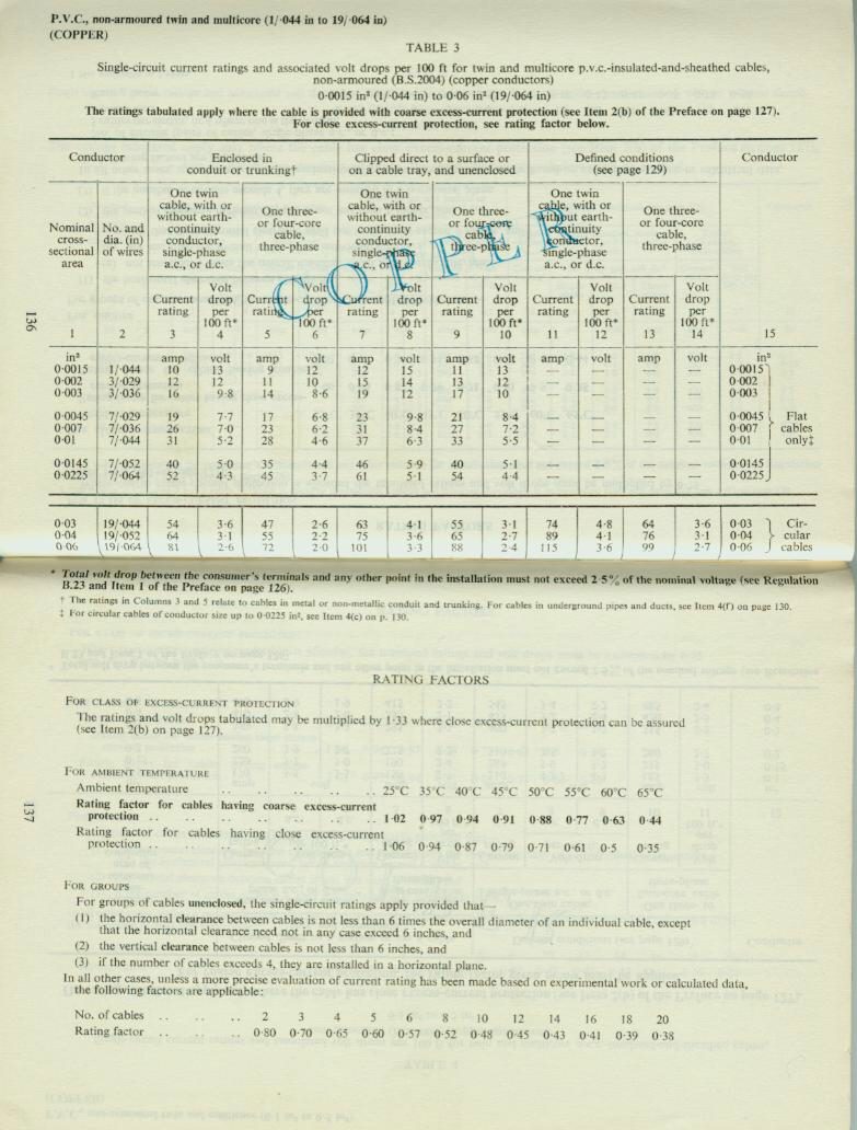

We already have this table of Imperial cable current ratings from the 14th edition on the site, but it doesn't include ECC/CPC sizes:
https://www.electrical-contractor.net/pc/IEE1966_T3.JPG

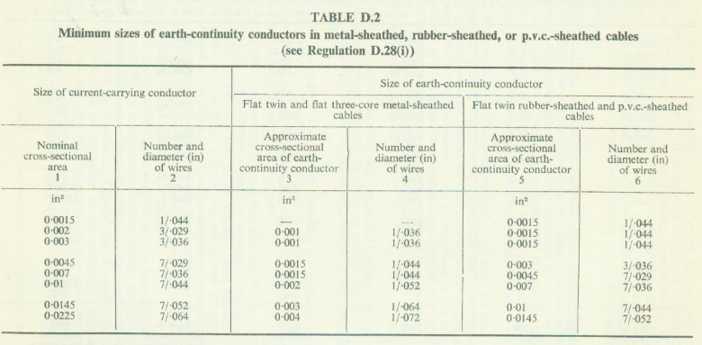

Here you go -- From the 14th edition, 1966:
https://www.electrical-contractor.net/pc/IEE1966_TableD2.jpg
