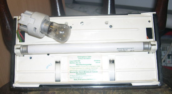

From John Harrison:

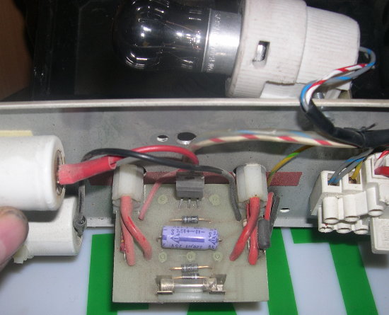

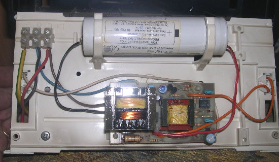

Old & dangerous emergency lights
These two fittings are only two of seven that we have replaced in a local chinese restaurant today,
The one fitting with the MES (miniture edison screw) lamps sill operates as an emergency light but having a bayonet fitting with a pygmy lamp running off of the supply is not a good idea.
the local fire officer had been onto the site and ordered them to review the emergency lighting system.
our company was asked to quote for the work and got it,
i am never surprised by the state of such fittings, but these were new one to me!!
the ages of the fittings were, the oldest 1981 and the newest 1984 !!!

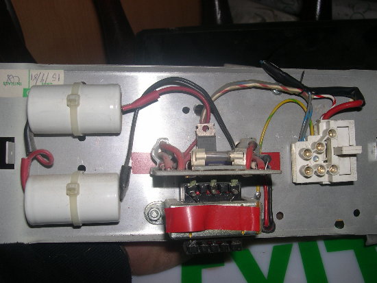

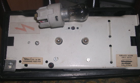

Maybe there's something in the photos I'm missing, but I can't actually see that much wrong. The fuse on the PC board of the first one looks as though it's been replaced with the wrong type. On the second fixture it looks as though the resistor below the transformer might have caused a little charring to the board, but I can't see anything else that really stands out as a problem.
John,
What's the problem with a BC pigmy lamp?

Paul,
as you are aware in regard to having a pygmy lamp (or any other light fitting) attached and connected to a fitting internally that has not been `factory` fitted is considered as incorrect,
if you needed a maintained (lit at all times,) or a sustained, (one source of illumination that is fed from one side of the supply, and emergency lighting control gear seperate,)
you would fit one.
what i can see that has happened, the fire officer has visited the site and told the occupants that the exit lights neede to be lit at all times, so mr sparky (i use the term very loosley) fits a cheap lamp fitting and puts a bulb in it.
this is not done, and does not comply, also the use of incandescent lamps within emergency lighting fittings is now also not allowed,
a bit of reading for you on this is BS5266 parts 1 to 7
also another good one, (or not so good if you are a company owner ) is the new RRO,
the Regulatory (fire) Reform Order which is now in place as of October 2006.
this is a nightmare for busineses
all in all, you should not adjust, add or remove any parts of a fitting in order to change its use.
Ah.... For some reason I hadn't cottoned on to the fact that these started out as non-maintained fixtures. Maybe it's because the color-coding on the wires to the BC lamp holder in the first one appears to match that of the (what I had assumed to be) original wires to the PC board.
Looking at the connections in the second fixture, it's clear now that the holder has been added.
I hadn't realized that, but this isn't an area I'm involved with (funnily enough I've just installed two new emergency lights, the first I've had anything to do with for ages).
