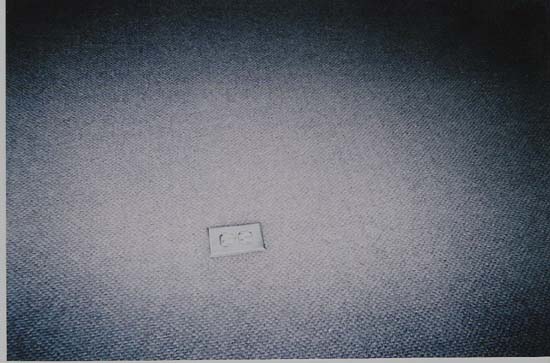

These are in a new commercial kitchen under a peninsular food prep counter. What do you suppose the installer was thinking?
Submitted by Lostazhell
#121180 06/21/05 09:09 PM
OK- so he didn't use a 'real' floor box! Let's at least give the guy credit for having his heart in the right place; there is a gasket, the cover will keep stuff from dripping in, and -if all are placed like this one- they are out of the way of foot trafic.
Not that I expect the covers to last very long!
Even a rated floor box would allow stuff to drip inside, and surely wouldn't keep mopwater out whereever there was a plug inserted. I think this application would be better served by "tombstone" pedestals for stuff under the counters, and drop cords for everything else.
As nice, reliable, and prooven GFCI's are, they are no substitute for good design.

I bet he was thinking "damn architects.. how the #@^% am I supposed to do this, and keep the outlets dry when they mop the floor?"
I second that thought.
I doubt an electrician decided that spot needed floor outlets.
At least they are GFCI. [Linked Image]

Personally I would hope that a GFCI CB feeds these outlets. A wash down would most likely drip on the unprotected (line) side of those GFIs. IMHO putting any recepts on the floor in a washdown area like that is like playing Russian Ruelette. Pendants from the ceiling would have been my choice.

In this government building, the floor is liberally sprinkled with receptacles like this one. Cut-in box, device- and cover suspended above it all by the carpet and padding. What was that rule about space between the box and flammable materials? Figure there's a 1/4 inch gap at each one. Oh, and wouldn't you like to be the carpet cleaner?
At least, with a receptacle under each cluster of desks, they weren't using extension cords.

FYI.... The prints called for cord drops [Linked Image] which is what they have now...
