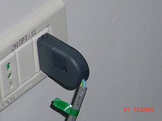

What type of safety violation do we have here, and/or is it really a safety hazard? Can this be considered an exposed "live parts" violation or merely an improper support violation?
Sparky74
Looks like this photo is from Italy, although I see a similar situation with British plugs all too often.
The problem is that with the missing cord grip the wire terminations tend to take all the strain of the cord being tugged and moved, which eventually results in broken connections.
I suppose from a European rules perspective one could also argue that with the sheath not extending right inside the plug the cord does not have its required double insulation -- At least not at the point where it enters the plug!
[This message has been edited by pauluk (edited 10-29-2003).]
Lots of people don't know how to measure and cut/strip double-insulated cords properly. I've seen the same situation with heavy-duty American plugs.

One good yank and that cord will rip out of the plug in a shower of sparks. Even more dangerous with a female connector, I guess. [Linked Image]

Like Paul and Sven have said, the outer sheath should be held by the strain relief inside the plug. I suspect the reason for the cheating is that with a grounded cord as seen in the picture, there very limited space inside the plug.
It is not an immediate hazard, but with time the small bending radius will destroy the wires, creating a fire hazard and/or shock hazard.

A very common one [Linked Image]
Almost every power strip or extension cord I see around here has that problem. Sometimes the cord grips are useless right from the beginning, sometimes they're cheap plastic and break, or the people are just not capable of using them properly. Yanking the plug out of the receptacle by tugging on the cord adds to the problem, especially with Schuko plugs that usually grip pretty tight.
The Italian plugs I know are pretty spacious inside, so there's absolutely no reason for doing this, apart from sloppy work or cheap materials.
The picture definitely looks like it's taken in Italy, but why on earth is it labeled 220V? All receptacles there are 220V, apart from red CEE ones.

Sven, maybe all you need is a screwdriver. Most European plugs I've wired allow for quite some slack inside, so you can just open the cord grip screws, push the cord back in and retighten them. Though I'd also have a thorough check on the terminal screws, maybe the connections have gotten loose from the strain, and if that thing wasn't installed properly right from the beginning the connections are probably none the better than the strain relief.
BTW, it pretty much looks like a fancy design plug, and those can be pretty flimsy in some instances.
The marks on the cord look like it has once been under the strain relief but has gotten loose. I'd guess loose screws and nice strong pulls on the cord.

Whoever guessed that the pic was taken in Italy is absolutely right. Oustanding!
The building where the pic was taken also contains 110V receptacles. For this reason, all receptacles are identified.
The numbers at the top of the cover plate correspond to the panel from which the receptacle is fed.

not sure about violations but in the usa if thats in a factory or place of buisness and OSHA see's it. Its a fine and we use to have to go around and check all the plugs in the shop once a month after they busted us for it. Most of ours were from people pulling the cord instead of the plug everyday.
