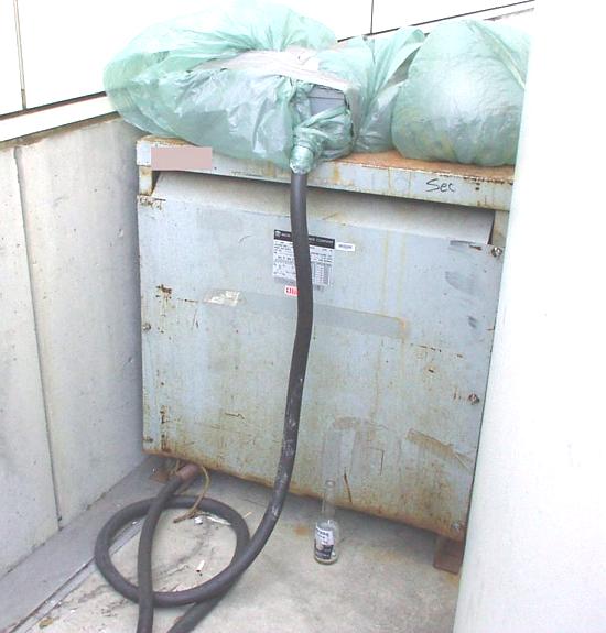

Isn't it about time they disconnect this thing?
- Scott (Electure)
#114249 02/08/03 12:05 PM
looks like sombody had a Corona and thought about it.....
#114250 02/08/03 05:24 PM
The plastic bags are a dead giveaway. Secretly, someone liked the idea of Joe's lemon-scented "marine" cord & receptacle so much they made an industrial version!
The construction-site “temporary” motif would be more authentic if the drytype was nailed to a beat-up wooden pallet with half-inch drive straps.
#114251 02/08/03 07:36 PM
Then again, many dry-type transformers run so hot that they make a great place to bake a package of Quiky-Mart pastries and boil up a pot of coffee in no time. (I’ll be that’s what’s really in the plastic bags.)
#114252 02/08/03 08:34 PM
I like the fact that someone took the time to label the Primary and Secondary sides of the transformer [Linked Image].
#114253 02/09/03 01:11 AM
Posts: 2,724
Broom Pusher and
I'm with Steve (Sparky)!
After 6 - 12 Coronas
What Were We Supposed To Do??? [Linked Image]
Scott35 S.E.T.
Scott " 35 " Thompson
#114254 02/09/03 03:12 AM
It looks like a huge old refrigerator....the kind the grocery store uses for milk and ice cream (and beer). [Linked Image]
Is this on the roof of a building somewhere??
#114255 02/09/03 09:04 AM
Posts: 6
The rust stains on the concrete indicate that the "temporary" transformer has been there awhile. They also indicate that it gets wet or rained on.
I don't believe this enclosure is rated for wet locations.
#114256 02/09/03 10:15 AM
The rascals that did this could have seen Joe's floating TV cord. It's on a landing at the LA Convention Center just a couple of hundred feet from where Joe spoke! [Linked Image]
All rated NEMA 1 (until the trash bags and Ductape on the disconnects). Secondary ran through a hole in the wall to?? Apparently no GEC, either.
