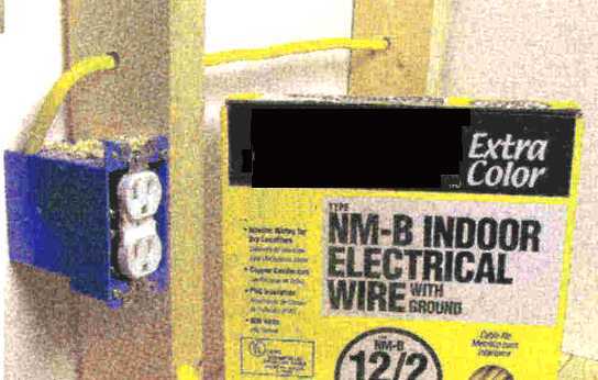

Hey guys, I found this ad in a non trade magazine agout Georgia based companies. How many code violations or at least oddities can you spot?

wire not stapled,old work box used,device installed prior to finish.

The box appears to be mounted flush with the stud, no allowance for the wall covering.

Wouldn't you think a manufacturer would make sure they represented the product in a proper way? How do they expect they drywaller to chew up the wires with a rotozip if they've already put in the device? [Linked Image]

No nail plates.
If this is going to remain unfinished
he should of used a metal box with cover.
(I know, not code but it is more robust).
Also did not wrap outlet with tape, again
not a code thing, just a courtesy item.

Why would you wrap a receptacle in a nonmetallic box with tape?

Yeah, Don, I see something black there, upper right corner of the box... But, the noodle terminal screws are still showing?
They only tape the hot side?
I've always felt that bored holes should fall under a similar reg as condiut fill. Say, a minimum 3/4" hole for a 12-2-G NM Cable... Looks like a 9/16" hole, but I guess there are no NEC regs to police this...

The wire box says 12/2, but the wire in the holes is round, like it is a 12/3.

Don, it's just a little extra safety measure. In case the wall plate - for some crazy reason -becomes permanently separated from the outlet box, you don't want exposed terminals where someone could slip and touch them. I always wrap tape around new switches and outlets when I replace an old one.
