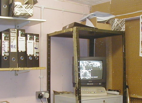

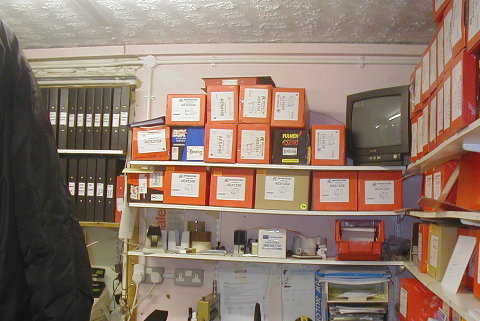

As there was quite a bit of interest in this thread I thought I'd snap a few "after" photos. As you can see, I've rewired throughout in PVC conduit.
Two duplex recepts. ("twin socket outlets" in Brit-speak) are now in the office in place of the previous one-outlet lash-up:
This is the area which formerly had "T&E" (NM-style) cable draped everywhere to feed the office (the pink-painted trunking now contains just the CCTV cables):
A couple of shots of the same areas pictured above, as they are now:

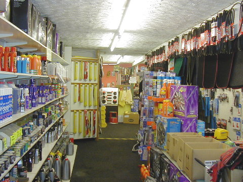

The central aisle, not pictured before but it had a variety of fluoro lights at all different angles and with the same sort of lash-up wiring. Now just four 8-foot 100-watt fixtures in a line:

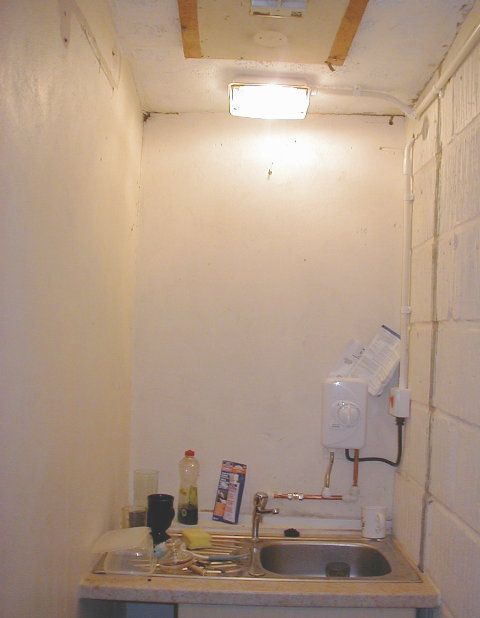

The former W.C., now turned into a proper kitchen area (remember this place started as three separate units, so there's another W.C. at the back). The old fan is still on the board at the moment to keep the hole covered up. The proprietor is going to "do something" with the ceiling before it's painted. Not my department! That's a 7kW instantaneous water heater over the sink unit now:

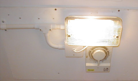

The fan and light wiring in the rear W.C. was as bad as that in the one above. Here's what it looks like on the ceiling now. We retained the original exhaust fan:

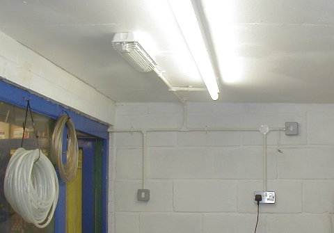

Now the rear storage area. The blue door used to be the exit into an alleyway at the back of the complex, but this has all been covered in now and shared between the different stores. There's a fire door (crash bar to open) at the opposite end, so this constitutes the second fire exit, hence the emergency light (3-hour, non-maintained):
P.S. In that last pic, my conduit is level, but unfortunately the ceiling and blockwork are not! What can you do? [Linked Image]
That's the point where I usually decide to put my stuff parallel with the building instead of level. Just looks better.
For example, almost all of the light switches are slanted here... but no one notices because they are parallel to the door frames. Had I put them in level everything would look crooked.

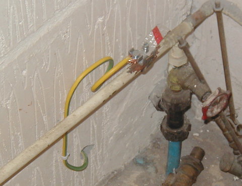

Here's the main bond to the water service.
This is our standard type of pipe earth clamp, used here with 10 sq. mm. cable (roughly equivalent in size to #7 AWG):
Actually, this is one of two main bonds, since the building still has two water supplies in use from when it was separate units. The bonding cable passes uncut through the clamp on the first service. (And you don't want to know what state the bonding was in before.....)

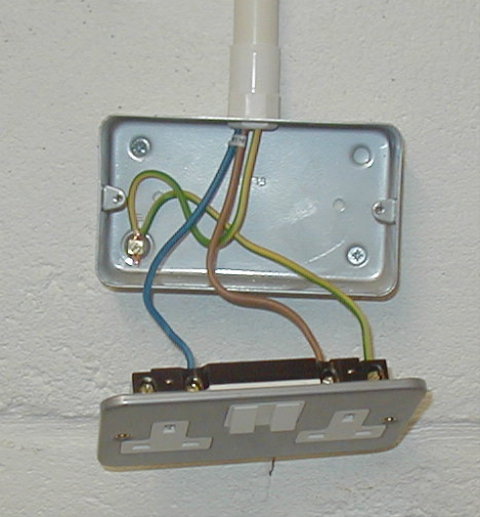

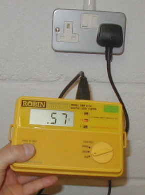

Here's a double socket outlet, which as you can see happens to be at the end of a run (it's the one in that rear store/exit area). Our Regs. don't actually require a separate connection between the socket and the backbox so long as at least one of the mounting lugs is fixed, but I always like to fit one anyway. New "harmonized" European colors now, of course:

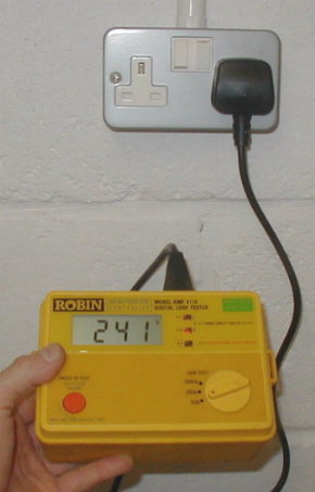

Here's that same outlet fitted, energized, and being loop tested:

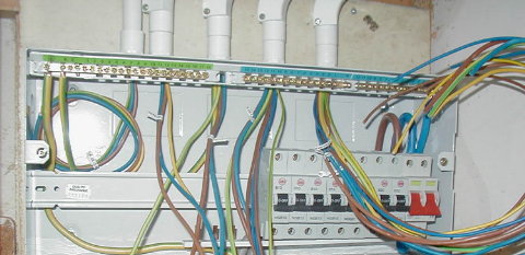

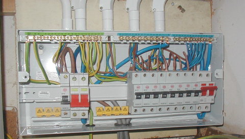

And finally, the new distribution panel, partially installed:
All circuits now in place, just waiting for a quick "tidy up" inside (forgot to snap a photo after that, sorry!):

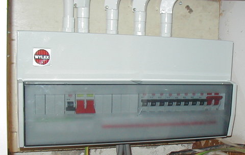

And all finished, other than the inspection labels etc. to go on the outside:
The left-side main and MCB (16 amps) are the off-peak supply for the solitary storage heater.
The other circuits, counting from the right are:
1. 32A Water heater
2. 20A Sockets: front of store & window
3. 20A Sockets: central sales area, kitchen, side storeroom
4. 20A Sockets: counter, rear, office
5. 16A Sockets: tool display & counter
6. 10A Lights: two aisles
7. 10A Lights: third aisle, store, kitchen
8. 10A Lights: behind counter, rear area, office, W.C.
(Sorry, fellow Brits, no ring circuits employed on this job at all! [Linked Image] ).
Conductors for the final circuits are 1.5 sq. mm for lights, 2.5 & 4 sq. mm. for sockets (larger size needed in some conduits due to derating for groups), and 4 sq. mm for the water heater.

Paul, the distribution board above (pic #2 in the last post) am I correct in saying you would remove the yellow tabs then screw a new breaker on to the exposed connection?
Also why no ring main circuit, I thought that was the norm for UK wiring.
Correct. Over the last few years our panels have acquired all manner of extra insulation so that just about all "hot" parts are still covered up even when the outer cover is removed. If you look in the picture just above that one I hadn't fitted the yellow covers yet, and you can just about see the lugs on the copper busbar behind the wires.
Yes, the ring is pretty much accepted as the norm and you'll find it used in most new installs here (domestic and commercial), but radial circuits are equally acceptable. Our "Regs." have included certain standard radial circuit arrangements for a long time.
Personally, I'm not a fan of the ring circuit and try to avoid it whenever possible. In this particular place -- much longer than it is wide and with the panel at one end -- radials are easier anyway, in my opinion.
