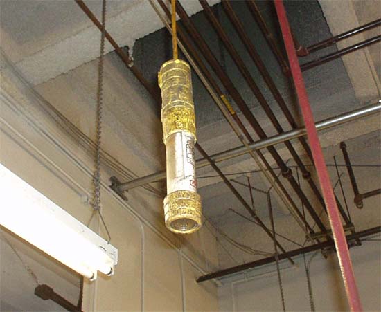

Maybe this will work for you.
Since the area below 18" is classified, we put handlamps on a (>18" from) ceiling mounted cord reel.
When fully extended, this light will not quite reach 18" from floor level. Therefore, it's not in the classified area.
Most of the work is done with the vehicle on a hoist anyway
Now if they'd just quite buying the ones with the convenience receptacle in them.......
