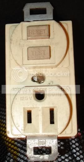

E57:
Leviton makes a single GFI with a sp switch combo device. $20-$25 range, I think. Other than that....
Dead front, single recept as above.
[Linked Image from img.photobucket.com]
This is the only one I've ever come across....
Likes: 10
Lostazhell:
Is that 'available' to buy??? Or is it something you came accross???

Posts: 947
That GFCI receptacle is a Bell device.
(while they were still owned by SQ D)
