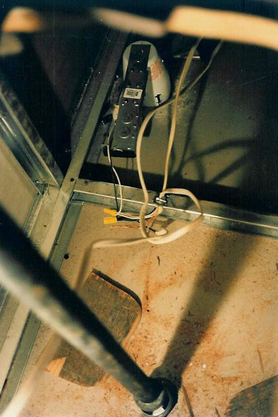

This next picture is just to hard to believe. It is not bad enough that this was all done in romex, a violation in this town, but apparently the metal stud seemed like a good place for a romex connector.

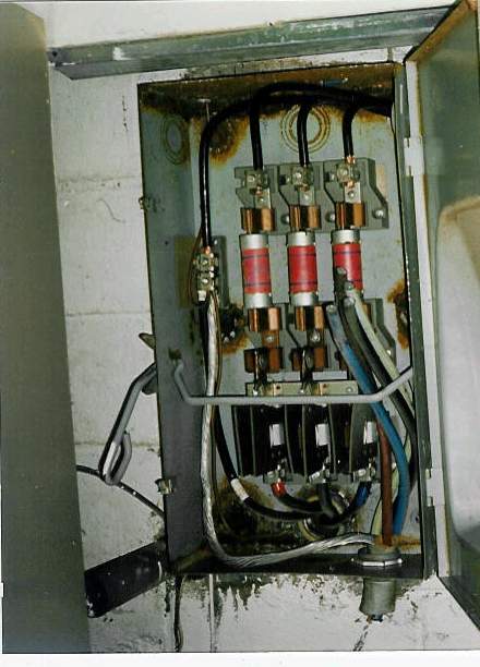

Just in case you are wondering. The disconnect in this next picture is being used and was wired as you see it. The person who wired this didn't feel the need to replace it I guess and while he was at it left the old wires in the box as well.
Needless to say it cost this customer more to fix this mess than the original job would have cost. Not to mention the downtime for his restaurant.

Is that romex connector really connected to that metal stud?? [Linked Image]

I honestly don't remember if that romes connector was in the stud or not. This was not done by a restaurant worker, this was done by a so called electrician. This building was gutted and the work you see was new. Hard to believe I know. At the time I tried to track down the electrician as well as the inspector but I was met with a lot of resistance.
Turned out the electrician was using someone elses license number and the inspection agency just frustrated me into submission. The customer in this case had paid $12,000 for this horrendous work. Amazing, isn't it.
