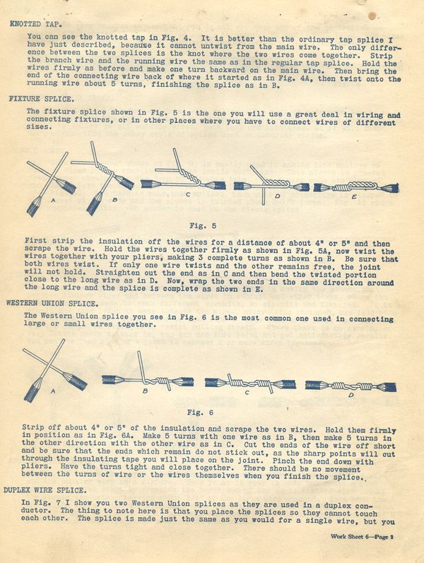

Here's some more pictures for our (upcoming) Nostalgic Area:
(Some picture quality sacrificed to speed up loading times)

WOW! I CANT TELL IF THEY ARE SPLICING WIRE OR GETTING THEIR FISHING POLES READY. QUITE SOME CHANGE FROM THEN TILL NOW!

Thanks for the scans--these are great. A change, indeed, from today's crimp-it, microwave-it, e-mail-it, overnight-mail-it, etc.

The Western Union splice technique will come in handy next time I have to splice a broken telephone wire in my house!!! [Linked Image]
I'd use heatshrink to cover it though....instead of tape.
I've actually used quite a few of these splices myself in telecoms/electronics work!
The "Western Union" splice was also commonly found in the U.K. in GPO Telephone manuals.
Sure glad that that is a past practice [Linked Image] I am very grateful to the feller(s) that invented wire nuts and kirneya!!
