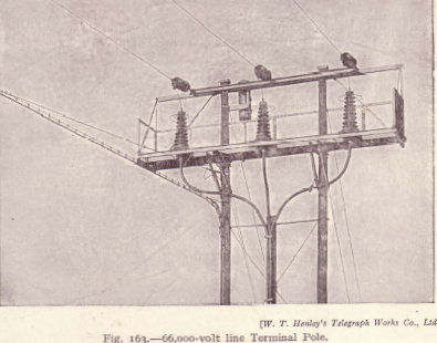

Thanks to Alan Belson for the following scans of 1920s lines and equipment.
Attached pic of 1926 UK 11kv terminal transformer pole. This is the dawn of the 'grid' - before this, individual power stations operated close to consumers, so transmission over long distances was unnecessary.
Two-circuit 11kV lines in 300 ft. spans:
Design of poles for 400 ft. spans:
Click here for enlarged version
66kV poles & lines:
#144716 01/12/06 07:31 AM
