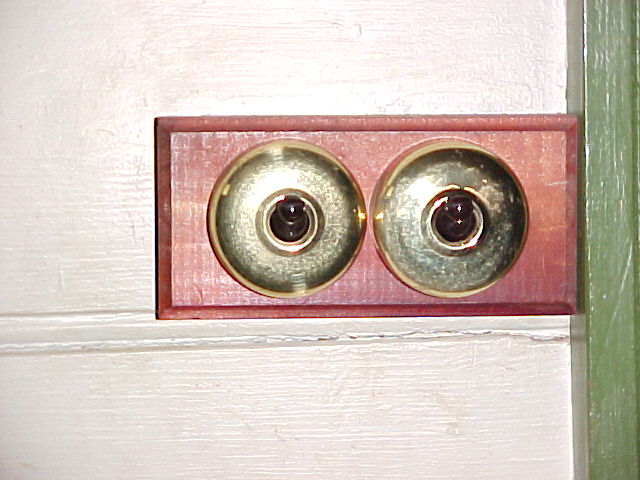

As a further example of surface mounted fittings are the switches in my hall. The mounting blocks are typically made out of pine. This style of fitting went out of favour by the late 50's, though they have come back into fashion for period home renovations.
