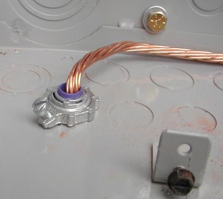

Is the 1/4" Knock-out hole in the bottom of some 3-R panels and discos an additional "weep" hole (they already have two, one in each corner...) or are they intended for use for the GEC to pass through?
If not, what type of connectors are listed for #6 and #4 bare copper solid soft drawn wire? The NM connectors I buy are only listed for 2 14-2-Gs to 1 10-2-G NM or UF Cables.
I have a feeling I've been doing this wrong for a long time...

What's the hole for? Nothing in the Disco Instructions pertaining to it... ![[Linked Image]](https://www.electrical-contractor.net/ubb/confused.gif) Thanks, John... (looking forward to the mail) <dumb question> What's an MNC connector? </dumb question> Crap, won't get to put the "100% Code Compliant" sticker on the service I did today... [This message has been edited by sparky66wv (edited 09-14-2002).]

This first pic shows the weephole to the left, and the 1/4" KO to the center. This second pic shows the weephole on the right. So, what's it for? <perfectionist> Man, I didn't notice before how crooked the washers were... </perfectionist> [This message has been edited by sparky66wv (edited 09-14-2002).]

What brand of Connectors are listed for #6 or #4 bare? Once again, mine are only good for specific cables... So, either there needs to be a listed connector or there needs to be permision to use the 1/4" hole. I don't see any other options. ![[Linked Image]](https://www.electrical-contractor.net/ubb/confused.gif)

But can I put my GEC through it? If not, what type of approved connector should I use? ![[Linked Image]](https://www.electrical-contractor.net/ubb/confused.gif) [This message has been edited by sparky66wv (edited 09-15-2002).]

(A clip from page 39) Where do I find similar online info for a GE TM820RCUFL 200A 3R Feed-through disconnect?

My synopsis: since there's no listed connector for bare solid copper #6 or #4 wire without armor, then a raceway must be used.
The weep holes (if that is what they indeed are) need to be opened to allow drainage, but somehow must also comply with 110.12(A)...
Does this sound reasonable?

But Don, they're only talking about the KO that is inside a 1/2" KO...
In other words, the one in my pix is left out of the options!
