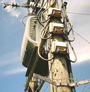

The cables taking off to the left supply a farm straight across the road from this, there is another pole supporting these cables, but the 5th wire isn't carried on from there. I'll take a picture when i'm along there tommorow [Linked Image]

Most of these systems have been replaced with a Buried system that goes very deep down into the ground and uses huge bare copper/steel rods, the last one we drove was 14m long. [Linked Image]
Oddly enough Ryan, are those spikes below the Secondary fuses, some sort of an anti-climbing protection?.

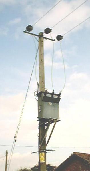

Guys,
How come there is no protection (Fuses) on the Lineside of the Transformer?.
Unless they are at the other end of the Spur line.
I was always taught to install Primary fuses above the Transformer, where the HV droppers come down to the Xformer, this is done for convenience and saves the Lines crews or Faults staff having to go and find the fuses, which in some instances has to be done quickly. [Linked Image]
Yes. The brackets have four short arms spaced at 90 degrees with barbed wire run between them. You can see the idea a little better in this photo:
It's not standard practice to use primary 11kV fuses at the xfmr here, and you'll see the HV lines just tapped and run straight to the xfmr all over the place:
[This message has been edited by pauluk (edited 11-01-2003).]
