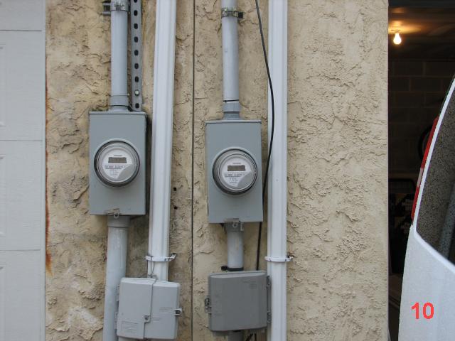

These pics came from a house that is 4yrs old, in a high dollar neighborhood ($600,000.00) in Philly.

4-gang with bundles of wires, switches not grounded. No outlet on counter. Romex in plumbers pvc. 25' of unfused cable hanging on plumbers strapping. A mess inside and out of panel. Central vac flopping in the return and the 90 not connected. No staples, meter sockets not level. I don't know what you guy's want, it works don't it. And yes there was a rough and finish inspection.

Pic eight is a prime example of why, in another thread, I had mentioned I don't care for wirenuts in a panel. [Linked Image]
