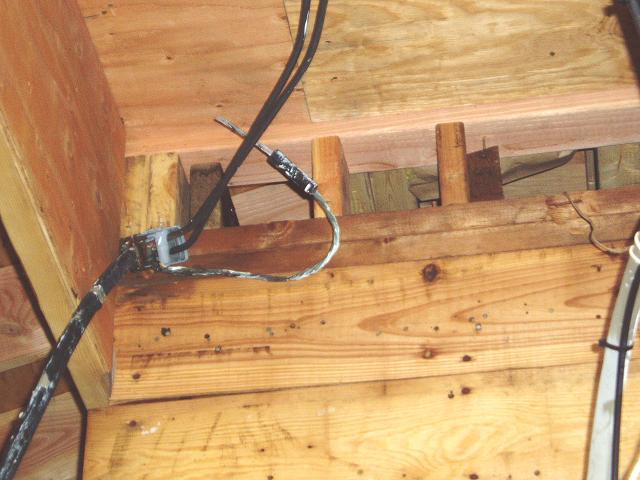

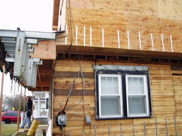

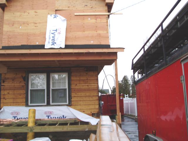

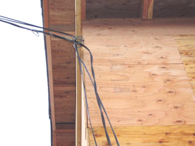

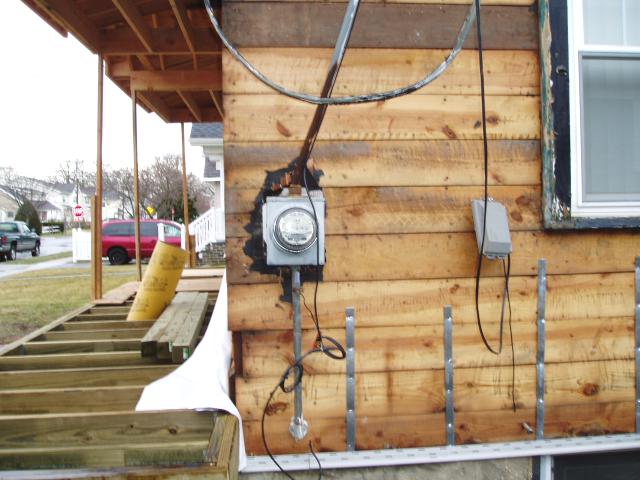

These pictures are a service our company will be upgrading. Notice the cut neutral. they are getting the return by way of water pipe.

What's that funny looking gound thing in the last photo?
You'd better get out and make up the neut or disconnect this service before they kill a plumber.
If a plumber cuts through the water pipe ahead of the GEC's connection, the plumber will become the new return path.

the service was changed the next day. It is scary what people will do to save time and money to do something that could have killed the plumber that was working at this house.

what's a gound?
Thot's e mosprant, I thomk.
