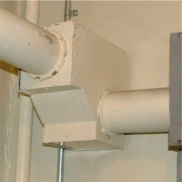

Another 'impressive' job was the use of a wireway 'ell' in place of a conduit body or bend. [Linked Image]
This was repeated 3 or 4 times, besides the fact the wireway should be supported and it is just plain ugly work I know I would not have enjoyed getting the four 500 or 600 Kcmil copper conductors into that fitting.
