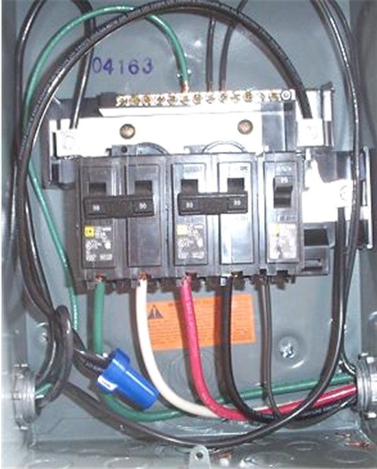

Bob,
Most of the 3/4" LTFMC we use is listed as an equipment grounding conductor up to 60 Amps, 1/2" to 20 Amps.
LT can be an EGC, up to six feet total.
250.118(7)(d)The combined length of flexible metal conduit and flexible metallic tubing and liquidtight flexible metal conduit in the same ground return path does not exceed 1.8 m (6 ft).
It looks to me like more than six feet in the photo and I just get the feeling the entire run is in un supported LT. [Linked Image]
[This message has been edited by iwire (edited 05-25-2004).]

Yes, Bob, you're right!
I had completely spaced out & forgotten the 6'limit...Sorry...S

Might have been color blind? And the other violations, well we'll just chalk those up to a very hard drinkin weekend and this was the first job on a monday morning for them. or they paid the home depot gut to come out on the side and do it.

So is the terminal strip at the top a grounding bar (green wire coming in with feed from the left) Or is it a neutral bar (black wire coming in with feed from the left)?
There I go assuming the feed is the left hand side. [Linked Image]
#117164 05/27/04 07:30 AM
Oh my, What a concept! Feed from the right! [Linked Image]
We are also assuming that the bar is at ground potential. It could be hot, and one of the other legs could be the neut (except for Randy's V readings).
There you go using common sense again, Bob [Linked Image]

Alrighty then! Here's the deal as far as I could gather...
Customer called someone from the "Thrifty Nickel" to move the subpanel as he was having stone work done on the wall in question & didn't want to see the panel from his "Theatre Room" window.. (Isn't the thrifty nickel the first place someone with an 8 car garage full of things like a Ferrari Enzo, Porsche GT2, 4 Harleys & a tour bus sized RV would normally shop? [Linked Image] )so it was moved about 40'.. (The length of the sealtite on the load side, line side was about 20'..) You can see how thrilled the homeowner looks [Linked Image] At first, the HO's wife told me she thought the lights were controlled by a timer at the pool equiptment area.. This is where I started my troubleshoot since the pool equiptment was running... Looked in the timers & found nothing, found a 2G W/p box kinda sitting on the edge of the fence & got the weird readings.. followed the sealtite back to the subpanel.
The terminal bar in the subpanel (Square D Homeline.. Depots panel of champions! [Linked Image] ) had BOTH neutrals & grounds landed on it... It does feed from left to right... (50A 240V from a seriously packed 200A meter/distribution combo) The 2 blacks on the terminal bar are neutral/ground for a BBQ about 80' away... At the w/p box, the hot was tied to neutral for the 20A ckt! [Linked Image] Course, how would he know? 3 black #12's! The original EGC from the w/p box on was #10..
I sent Bill more pics to post from this place to give a better idea of the layout & a few more things you guys might find provocative! [Linked Image]
-Randy

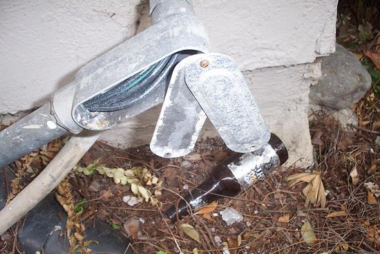

More pics to reveal just how expansive this place is! The photo of the 2G W/P box is where I came across the funky readings... In-use outlet, no GFI, No Cover!, ... Packed to the gills old Crouse-Hinds 200A meter/distribution combo, missing its dead-front!... (anyone else ever notice that the punie contacts on these 1/2 sized breakers seem to get "Zinsco-itis"!.. LB open upon my arrival! (Why do I seem to find alcohol & code violations together? [Linked Image] )

Besides industry accepted field practices, where is green prohibited from being used as an ungrounded conductor? [Linked Image]
In the first picture there would be a violation of 310.12(C) (just for one violation) in any case.
