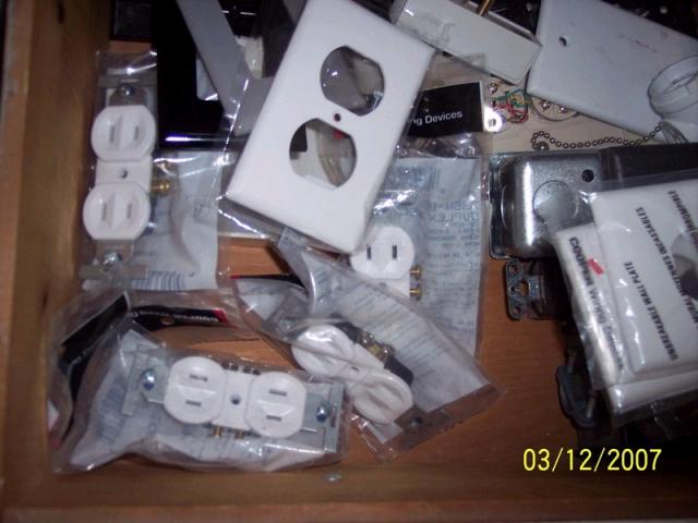

YES, I want this outlet replaced, but it's WAY down there on the list for some reason. (Not that the list ever gets touched, anyways.) NO, as you guys will like, I'm not allowed to do it.
Wait till your dad's not at home, go to Home Depot or whatever and buy a replacement 2-pin outlet.
Yes, they're still made for replacement use in situations like that. At least it will keep the plug from falling out.
Home Cheapo? Who needs Home Cheapo when there's an Ace Hardware within riding distance of your home?

#111829 03/12/07 04:10 PM
GIT R DONE!!!!!!
I have to say I have NEVER seen a 2-wire device like that brand new!
Those things are just not found here in Canada, and of course people just use a standard U-ground as a replacement, WITHOUT:

Come to think of it, option #1 is illegal now I THINK.. It used to be legal at one time, but personally if it is a " quick fix" for a rental property or where $$$ and the "wall damage factor" is an issue, option #2 is what gets done, If its not then I would choose option #4 and start from scratch..
#111830 03/12/07 04:16 PM
Hahaha....well then Ace works. I just mentioned HD or (B)Lowes because I've always seen them there.
Oddly enough, they're more expensive than the cheeepie 50-cent grounded types, and about the same price as the heavy-duty grounded types.
The two-pin socket is still manufactured and sold here for replacement use ONLY, in cases like Ian's.
I'm pretty sure I also have a couple new ones at home I can send you also *shrug*.
