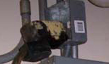

I found this pvc pipe on a job i went to. The maintenance guys on site said it's been this way for a couple of year's

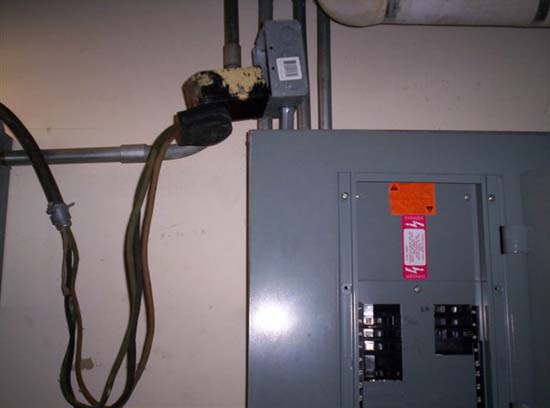

I also found this in the same building and no it's not a temp! Pretty scary huh?

In the 1st pic, Is that PVC just stuck into that panel? [Linked Image]
The 2nd pic, the paint on the outlet gives away it was scabbed from someplace else (someone's garage? [Linked Image] ) I'm trying really hard to tell how it's hooked onto that 4S or 5S box. The blank of the front of the box doesn't appear to completely cover the front... Hmmmm.. Did any of those maintenance guys fess up to creating this mess?

Ok Scott.... Cough it up! I've seen people do some pretty good jobs zooming in on certain details of a picture, but unless I'm really low on caffeine right now, you changed the orientation of the picture angle?? [Linked Image]
anyhoo... Ok, so... there isn't a cover on that box... I'd be afraid to see what's hiding in the panels here! [Linked Image]

the first pic. is pvc stuck in the panel with ( no conector) also blocking the lb cover. i belive they had a temp feeder for a construction project a couple of years ago, and used it as a sleeve ! go figure! with that in mind it would explain the 2nd pic, set up as a real bad temp. also never removed. and there are #6's coming out of the offset nipple. but the reason it's ok is it's in a local county gov't building where no inspections are needed!

Yeah but at least I see some Square - D in there! [Linked Image]
Quick question though, in that first picture... Above the panel it looks just from the colour on the sticker--> Is that some kind of ancient Federal Pacific Disconnect switch?.. Just curious as I have never seen one like that!
