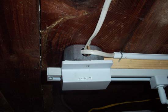

Behold, some of the things I showed a bit of concern over during a home inspection today....

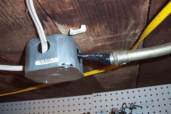

Is that white stuff zip-cord going into the boxes?! I know the yellow one looks like a flat three-conductor extension cord...

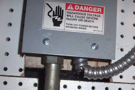

Is the flex in Pic. 2 going to a fitting, or it is just terminated inside the box somehow, or is it hidden by the box cover? (noticing the conduit connector beside, and nothing near the flex)

I think thats white Romex, Sven.
#108397 04/16/04 09:16 PM
Sven... The "white stuff" is indeed 14/2 Romex.. You also win the "eagle eye" award... That panel is indeed in a bathroom! Story is, that the bathroom was created from what "was" once part of the back porch.. Hence, the original location of the fuse box when this 1928 house was built...

Doug... There is a flex connector there.. the disconnect cover overlaps the can a little.. No ground in the flex BTW...

The sticker in picture #2 should say "Turn off power before working inside or outside"
Actually "Turn off power" might be better.
Picture #3 shows what to do if you forgot your pipe stretcher at home.
Picture #4 shows what happens if your pipe stretcher is out of adjustment.
