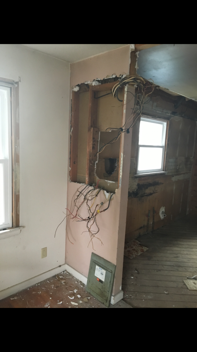

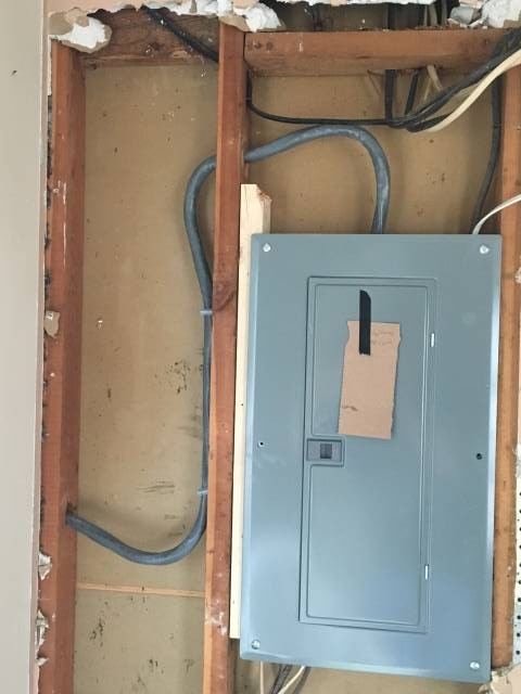

Hey guys, this is my first post so thanks in advance for your help.
I'm replacing a 100A service panel and it is on a 3ft wall that runs perpendicular to the exterior wall and this wall is lined up with the meter socket. The inspector said I will not need a disconnect if I am within 5 ft and that I should put the SE cable in pipe...
What type of "pipe" should be used for this 2/2/2/4 SE cable? Should I take my box down and make a hole in the side so I have a straight run? I am very close to that 5ft max the way I have it now running to the top of the box. I assume wire length inside the boxes are not counted toward that 5 feet?
Remind me of what size wire and ground rod I will need to add to this system please. The ground from panel to meter box is #4 aluminum
