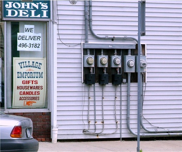

Here is a service I saw while in NY last summer it is on East Main St in Washingtonville, NY.
Are the black boxes under the meter service rated disconnects?
From this distance they look like HVAC cut outs.
Nice protection on the SEs [Linked Image]
