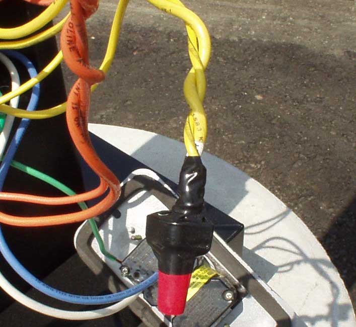

For Bjarney:
I too lived under a rock, until I saw the results of a "hot shot" with a battery drill.
This guy was also supposed to use Scotchcote, not tape, and a #10 ground to the GFI recp, but was too much of a speed demon to get it out of the job box.
He's gone, now...S
