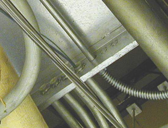

Found this one yesterday at a school. What you're looking at is a junction box in a ceiling. Notice the pipe running all the way through.

What's in the raceway?
At one time about 20 years ago, I too discussed this with the Former Chairman of the NEC Committee Richard Lloyd, and he said that this was acceptable if the installer wanted to accomplish the separation between certain types of conductors.
It does look funny, but what are the hazards and is it on a government site where electrical inspections may not be considered?
Joe
#114639 05/23/03 06:05 PM
I would be more concerned with the acessibility of the j-box with all of the other pipes and cables in front of it

#114641 05/23/03 09:07 PM
Posts: 717
Joe,
I consider it a violation of several articles, not the least of which is 110-3 which is how materials are to be utlilized.
The conductors are fire alarm conductors, and fire and security conductors are included in the box.
The disparate bonds are what concerns me the most. Should a fault occur on either the pipe, or the box, there would quite likely be a sizable arc to the item not securely fastened.
Walrus, did you forget to bring your bender with you to go around the box instead of through it? I don't understand. I have also shielded intrinsically safe conductors, but also managed to use connectors for a solid grounding connection or went around the offending item in the way.
Accessibility is one of the issues brought to the contractors attention.
#114642 05/24/03 06:55 AM
Posts: 680
Didn't forget anything but when its installed wrong and I'm sent in to repair another problem I try to fix it the best I can. The conduit in question mught be in the middle of 15 or 20 parellel pipes with only 2 feet exposed above ground with a vertical seal off. I realize some customer might pay to fix it right but in Maine where money is tight that isn't common. I see no problem putting a 4.5" nipple straight up thru a 4" raintight trough, putting a 3/4 myers hub on top and then continuing into the building. It may violate a code but its certainly better than having conductors that are supposed to be safe mixed in with AC controls. The conduit going thru is bonded by lock nuts just like the rest of the pipes.

#114643 05/24/03 07:25 AM

#114644 05/24/03 11:23 AM
Posts: 507
I support Walrus on this one.
Although I've never done this I often face situations where you have to make judgement calls about "making the best of a bad situation".....it's just part of the job.
