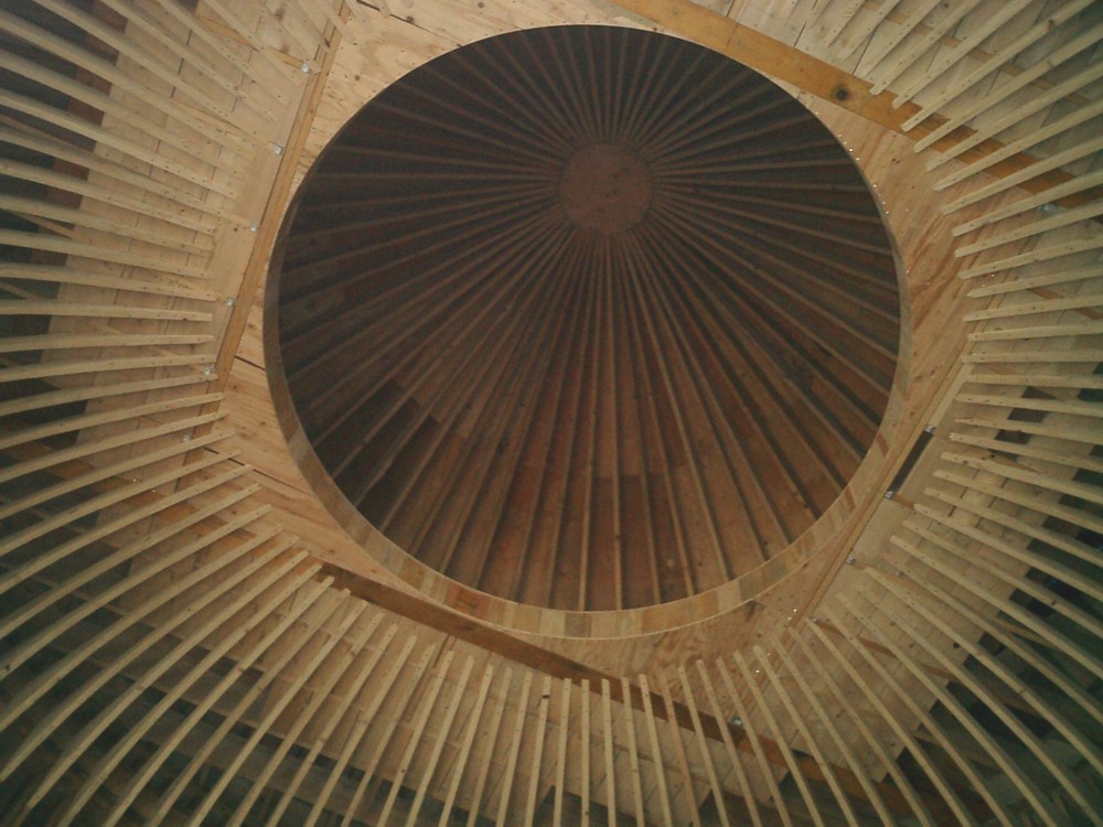

This picture shows how they framed the whole area out:
Click here for larger image .

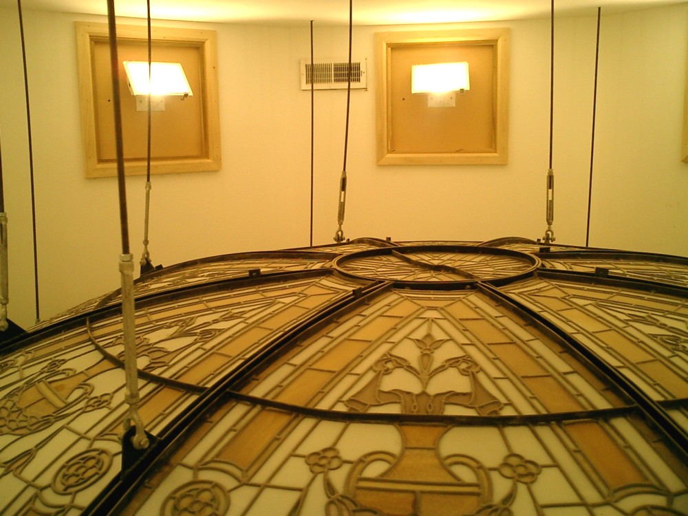

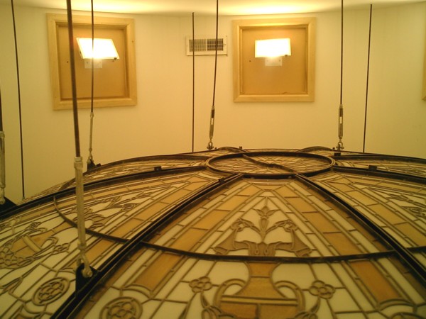

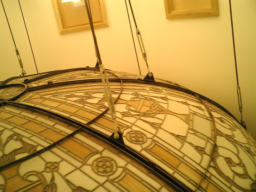

The next two pictures were taken inside of the attic showing 8-500 watt quartz light illuminating the back of the glass dome. There is a thermostat inside of the area which kicks on and vents that area if it goes above 90 deg F:

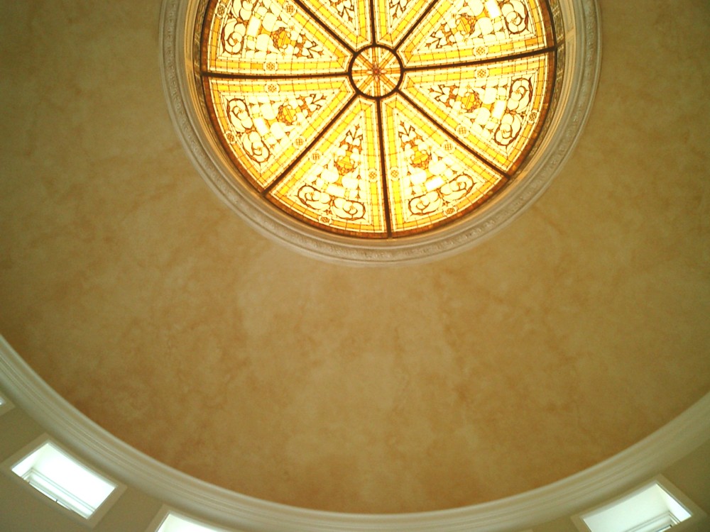

The picture below shows what it looks like lit up 2 floor below in the front entrance:

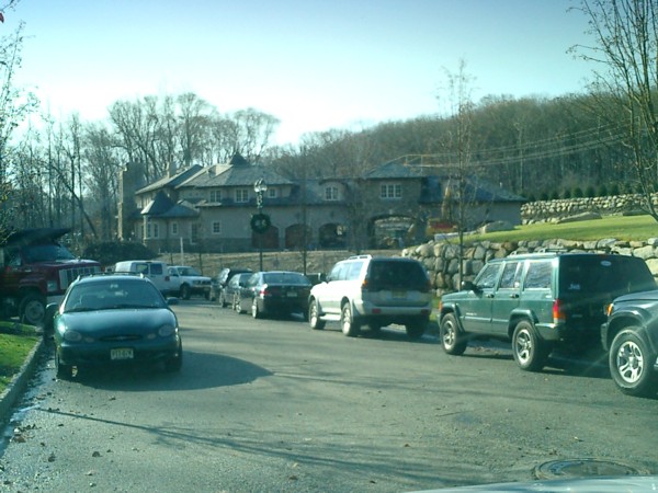

The picture below shows how large this house is. If you look at the picture, there is a large track hoe and smaller front end loader in front of the building:
