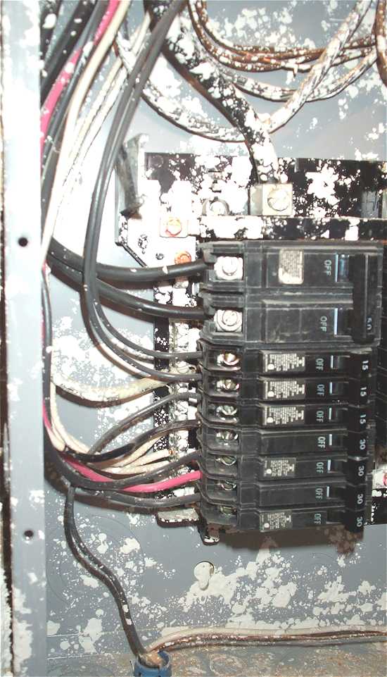

Here is Mikes' Condemned Panel;
Comments?
Likes: 10
Now that there is a mess.
Looks like there is "mud" on the lower right buss, also.
Hey, you sure that it's "spackle"??
Must have been one ticked off spackler!
IMHO, I would have it de-energized and cleaned as best as possible.
Code reference??? 110-11??
Home inspectors usually don't have a code book!
