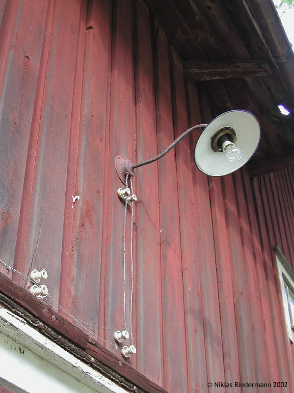

In Germany K&T was outlawed in 1910!
Usually it looked like this:
[Linked Image from home.swipnet.se]
I know a few houses in Austria that still have original wiring like that live @230V.
I love the way that stuff looks!
