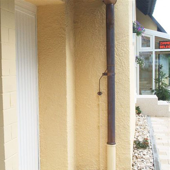

With copper prices the way they are how long do you think this copper downspout would survive the tweakers here? [Linked Image]

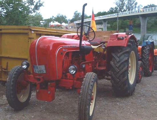

Here is a pic of a Porsche diesel tractor that I saw while at a celebration of a new bridge over the Rhine between Germany and France on 05/14.
How does it corner, Rollie?

Porshe made good tractors other than fast cars,
Has a very similar look as the older Deutz tractors which also had an air cooled diesel engine.
