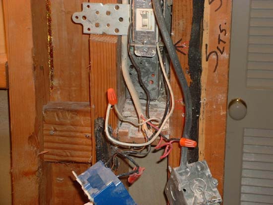

Here are a couple of reasons that I always make an allowance to rewire all my bath remodels.
This is what I found after stripping the drywall. The blue box had the back cut off so it would fit into the wall. All the loose wires you see are just how I found them.
Pretty scary!

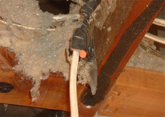

Can tell someone didn't have a clue or a care when that was done..
Question , in the first pic with that flying splice, what kind of insulation is that? looks like that cellulose stuff that I think burns quite nice. Just curious as I found a few splices like that in a wall stuffed with newspaper dated as recent as 1989.

I ran into something like this recently except whatever idiot that did it thought that wrappinr it with 2 rolls of electrical tape would stop any problems from happening or something...WRONG!!!!
#111224 09/24/06 10:04 AM
Posts: 209
Rewired...the insulation is fiberglass with a top layer of blown cellulose...you are correct!
