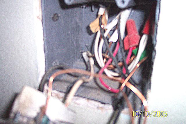

I thought you might be interested in these photos for your website. I took them last Saturday with the homeowners camera while tracing out an open circuit. I found the problem in a 1900 box in the attic. Of coarse that was the last place I looked! The home owners brother cut into a wire in the attic to pick up a feed for the paddle fan that he installed in the next room. The paddle fan was installed 3 years ago. Look how nicely he installed the receiver!

There are some people that should never be allowed near wiring, I think this guy may be one of them.
The connections in that box in the first pic look rather dodgy. [Linked Image]
Does this fan unit have some sort of a wireless remote on it?.

Cancel his fire insurance!

.....ok, I have no comments here. even my amateur level wiring skills are better than this. least all my splices are in boxes and use wire nuts.

Creative, but very dangerous. It is hard to get those receivers to fit where they belong.

Commenting on the first pic: Looks like a guy who's "really good at hooking up speaker wire" (notice the very small seperation in each NM). Also, "The neutral carries no current; no need for a wire nut!" And finally; cable not secured within 8 in of the box.
Extra points for using cable clamps and a box of sufficient size?? [Linked Image]
