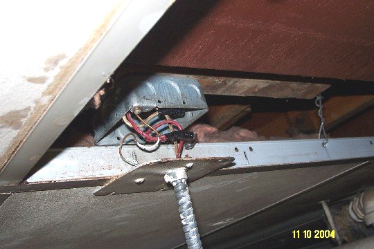

My first thought was "well, at least they made an attempt at grounding..." [Linked Image]

Man... I have been seaching for invisible extension rings and can never find them at the supply house. I wonder if that's a raco or thepitt?

This is located in an Antique Emporium. The owner was replacing a damaged ceiling panel and discovered it, then called me. The flex feeds the fan motor of a hot water unit heater which is no longer used. I disconnected it and installed a blank cover. The bare wire is looped around a screw in the cover and then to the box cover mounting screw. I admit, this is a first for me. [Linked Image]
LOL [Linked Image]
Roger
#107223 11/13/04 10:04 AM
Posts: 4,293
I think the same company makes them as makes that Invisidorf that George Corron keeps not seeing everywhere
Check your invoices, they should show a charge for them. Problem is that when you do an inventory, they are tough to count as you can't see them... [Linked Image]
