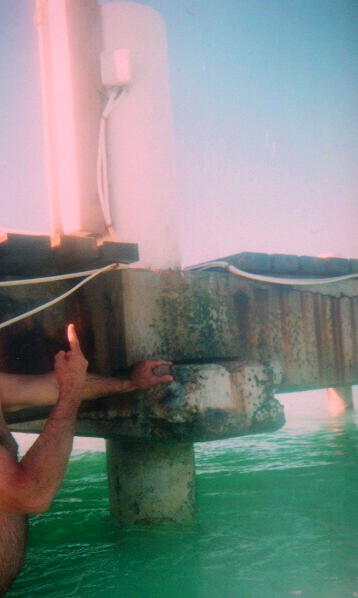

This was a nonmetallic boat cable and included all insulated conductors where the EGC was and insulated green conductor.
As this area is sometimes used as a reference for Vocational studies we request that comments be kept to the subject as much as possible. Thank You for your cooperation in this matter.
Is it supposed to look like NM?
Because that is what it seems like. The staples holding that wire are nicely rusted. What is the difference between boat cable and standard house-hold ROMEX?
Also,shouldn't that stuff be in some sort of conduit? It looks prone to damage if a boat slams into that pier.

Yes, it looks like Type NM cable, but it was identified as "Boat Cable" and it included one white, one black, and one green wire.
"Romex" includes a bare EGC.
Yes, the staples were rusted. This was taken in Turks and Cacios and that's me standing. in the water there.
No it was not in the Charles River!!
Yes, I think it should be in a conduit or be properly protected, but they may not know about the NEC there!!
Probably should review Article 555 to see if something could apply ... are you there CMP 19 Chairman??
Type UF cable is usually gray in color, and would be required to be sunlight resistant where exposed to the rays of the sun.
GFCI protection may needed for this circuit as well.
Again, check Article 555 ... that's your homework ...
This photo is proof that Joe is a pretty good guy. {Face it — some of us might have used a different finger.}

i will throw my 2 cent worth there also but the wire staples are rusted bad but one question how the devices can stand the evoerment and i belive that is salt water which it bring me memories about that. unforeturely the sec 555 deal with marine and the devices like boxes and etc should stand the salt water also that part it puzzle me for while but mandatory gfci is need no matter what size device will put out i did see 3 phase version use gfci also unforetaly i did not get the manufacture name for it. and the cable what i see it dont have proper support in case of splashing water and in winter time dealt with ice ( that add weight also)

555.19 only requires gfci protection for 15 or 20 amp 125-volt receptacles.The 30 to 100 amp receptacles supplying shore power do not require GFCI protection.
I have never seen anything called boat cable.Every dock that I have seen,wired,or had to troubleshoot was wired with either RNC or RMC.The only cable was from the boat to the outlet.(on floating docks,LFNC was used at each end of the bridge(gangplank?)to allow for varying water levels.

"Boat Cable" is similar to NM cable, but its intended application is for the electrical wiring on a boat. The big difference in the conductors themselves is that _stranded_ copper wire is used, nominally to provide better reliability in a high vibration environment, and the conductors are tinned, to provide better corrosion resistance.
The cable is certainly made to _different_ standards than NM or UF; for example the single conductor marine grade 14ga wire that I have at my desk is printed 105C DRY 75C WET OIL RESISTANT...TEW 105C or AWM... suggesting a higher temperature rating in harsher conditions than the THHN found in NM. The cable is also probably more flexible and less prone to mechanical damage in cold weather. The outer cover of the boat cable in the picture above is quite likely UV resistant, but I doubt that the cable is rated for direct burial the way UF would be.
One _significant_ difference is the stranding of the conductors and the tinning of the conductors. I bet that the various terminations in wire nuts or on the back of the receptacles have rather different performance and reliability characteristics with this finely stranded wire than with the relatively stiff strands found in regular THHN or THWN or the solid wire that would be found in 12ga or 10ga UF.
