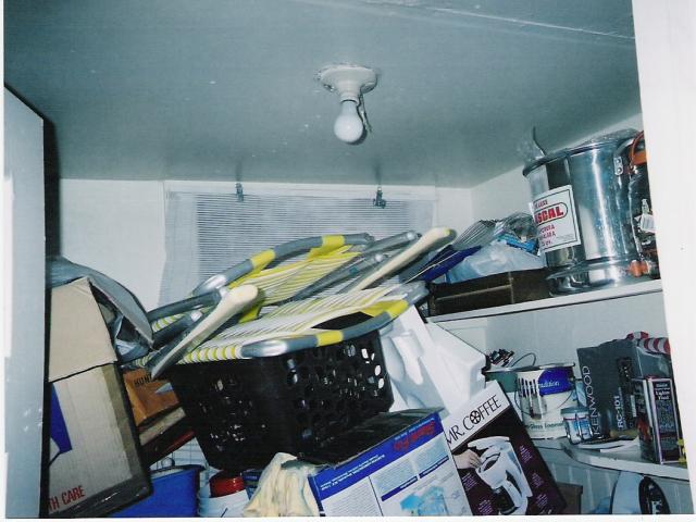

CLOSETS
Because they are a FIRE HAZARD when used with open light bulbs!!
Posts: 1,457
They must have been allowed at some point as there seem to be millions of these around. I see the potential danger here but I can't recall hearing of any house fires caused by these. Any stats on this?
they are everywhere here......
I see similar installations all the time in England as well.
I think it comes down to common sense on the part of the homeowner to not stack stuff where it will too close to the bulb. Unfortunately, common sense seems to be a vanishing commodity these days. [Linked Image]

This picture does not show a 'storage' space (shelf) above the hanger rod. 410.8(A).
As Joe has pointed-out, procelain (key or keyless) Lamp Holders are not Lighting Fixtures ( Luminaires ) and are not permitted in Clothes Closets (CC).

Here is a pic that shows why hot lightbulbs and closets don't go together....
And for those who don't believe in Murphy's Law....yes, I had to access a basement hatch that was under all this stuff! :-)
