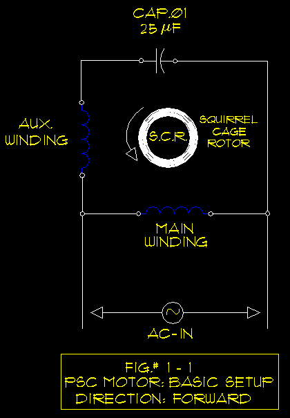

FIGURE #1-1: BASIC PSC MOTOR CONNECTIONS:DIRECTION = FORWARDThis Drawing shows the Permanent Split Capacitor Motor (hereafter referred to as "PSC Motor"), with Basic connection scheme for Forward Rotation Direction.

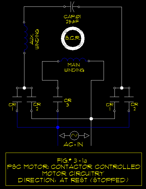

FIGURE #3-1a: DIRECTIONAL PSC MOTOR CONNECTIONS - CONTACTOR CONTROLLED:DIRECTION = N/A (MOTOR AT REST)*** MOTOR CIRCUITRY ***
This Drawing shows the PSC Motor with Contactors used for Forward / Reverse of the Motor.
Control logic State = "REST" (Motor is Off).
See Fig.# 3-1b below, for Control Schematic

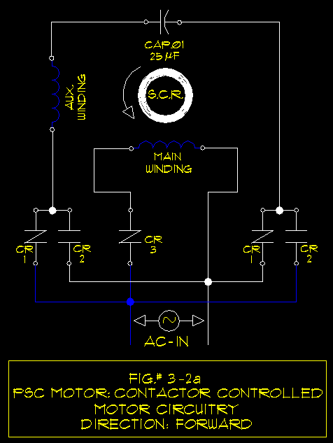

FIGURE #3-2a: DIRECTIONAL PSC MOTOR CONNECTIONS - CONTACTOR CONTROLLED:DIRECTION = FORWARD*** MOTOR CIRCUITRY ***
Control logic State = "FORWARD".
See Fig.# 3-2b below, for Control Schematic

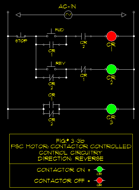

FIGURE #3-3b: DIRECTIONAL PSC MOTOR CONNECTIONS - CONTACTOR CONTROLLED:DIRECTION = REVERSE*** CONTROL CIRCUITRY ***
Control logic State = "REVERSE".
See Fig.# 3-3a above, for Control Schematic
