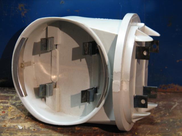

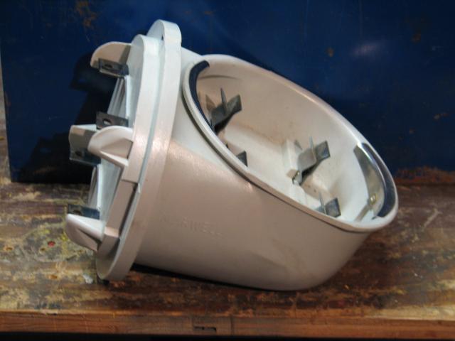

submitted by HCE727: ![[Linked Image]](https://www.electrical-contractor.net/Forum/Images/90-MeterSocketExt.JPG)  ![[Linked Image]](https://www.electrical-contractor.net/Forum/Images/90-MeterSocketExt1.JPG) |  |  |

I saw a picture of one of those in an  an older Murray- Jenson or Hydel catalogue somewhere. Never actually  have ever seen one installed. Have also seen in a Leviton catalog a meter socket extension that  is a "Transient Voltage Surge Surpressor". Not a bad idea IMHO.A.D

Joined:  Oct 2002 Posts: 482 Member |
Good idea, but I don't see the PoCos around here using anything like that. It seems subject to damage more than a regular flat install...and it looks plastic.(?) |  |  |
Joined:  Feb 2006 Posts: 144 Member |
They are plastic, at least the one I saw was. A co-worker had to replace one once that melted due to a fault. A neat concept, but, not nessecarily the most practical for all installations. |  |  |
Joined:  Nov 2005 Posts: 187 Member |
The concept of the meter socket extension is so the PoCo can read the meter. This extension was taken out of a residential garage. All the PoCo had to do was look in the window and read the meter. If the meter socket did not have the extension the PoCo could not read the meter.
 Hank
Joined:  Oct 2004 Posts: 806 Member |
Kind of a neat gadget, but as pointed out already not so good under fault conditions...and this one looks like the clips have been getting warm...
